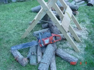

Did run to dealer this morning to get air filter. All they had was the maintenance kit( air filter, fuel filter, spark plug, 2 cycle engine oil) I showed them the old air filter and we agreed it was pretty much shot. Got home, put their plug in and checked for spark. YES!, next. Air filter in, STOP switch off, cranked it a couple of times, got a little hint of "I want to start". I then put 2 drops of gas line anti freeze (alcohol) on the air filter. 2 more pulls and it started up!
On my way to the dealer I seem to remember, the saw had sat for a couple of days on its side 1/2 full of gas. Maybe the way it was positioned caused the fuel to drain back into the tank creating a length of air in the line. The dealer agreed that might be the problem.
Thanks for all the suggestions. They really helped me get more familar with my saw.
My brother gave it to me about 4 years ago, when he moved from the Jersey shore to PA. They built a house with a gas fireplace and are not too happy with it. They miss the wood burning aroma to the point of walking the dog around the neighborhood late evening, winter, just to smell wood burning.
Did cut some wood today, Thanks again!
