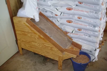

In my case, I usually need a 5 gallon bucket of pellets to refill my stoves for the night so I'm not about to lug a bag across my house, slit it open and pour PART of it into the hopper. Then stop the flow and cart it back out to the garage.

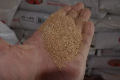

I wish I could say I invented this device but I got the idea two years ago from someone on here who posted a picture of a similar one. I just put the bag at the top, slit the bottom and let the pellets run down the chute and into the pail. Dirt simple, no dust, and less effort than doing the above. You can see that I only get the very fine particles separated. Last year, I got about a 5 gallon bucket of powder. Mix it with paraffin and you have 'starters' for camp fires or wood stoves.
The sifter you are referring to was a plastic one, I bet, that cost about $400. NFW!!!
It's everyone's choice and belief as to whether to sift or not but, to me, it just makes sense to lift the bag one time with no balancing while pouring, no spilling pellets, and no dust in the house. To each his own.

YET! No work at all the way I do it.
Hey,tjnamtiw, what did you use for screen ?
I first put a layer of 1/4" hardware cloth that I got from mcmaster.com but I was passing too many 'useable' pieces so I topped that with the widest aluminum window screening I could find.
It has a bottom in it to catch the fines and I sandwiched the hardware cloth with a strip of 3/4" square wood to either side but put a 'belly' in it. Had to add a couple of pieces of thin plywood that you see for deflectors but it works great now. I use three buckets, which equals one bag. Why even worry about fines in your stove? Easier this way plus no fines.
