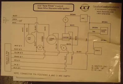

OK, my age is catching up with me. I violated rule #1 when servicing appliances by forgetting to remove the outlet while cleaning. My Glow Boy has the AccuTron 2 Control board which was unplugged prior to cleaning so I could remove the side panel and get access. When reassembling this, of course I got a surge of power to the board when I reconnected the harness to the circuit board. SInce then, the convection fan is always on and the igniter doesn't seem to stay on long enough to fire things up. Auger, combustion fan all seem to work fine. I can "coax" the pellets to light by using some starter gel and the stove works fine. Until I shut it down again. I have to let it run to cool and then the only way the convection fan shuts off is to unplug the unit from the outlet. I'm assuming it's the control board since I think chances are better I blew a chip on it rather than a switch or other component.

OK on further inspection I found that I had pulled one side of the igniter limit off. Probably when poking the vacuum around in there. Re-attached, hooked everything else back up and back to normal operation. I've attached the system schematic in case there's other Glow Boy users out there that need something to reference. Just a note, overall the stove has been great. No problems other than what I've created in the three seasons of use...

Thanks for posting the diagram, I see what you mean about the limit and the wire. I haven't seen one like that. Usually there are only 2 limit snap disc's on a stove. The low or POF and the Hi limit. Learn something new everyday.
