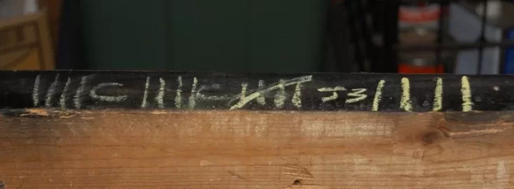

Three pics attached. My ready rack in the garage holds just shy of a face cord of splits, I am calling four racks worth one cord. The "tale of the tape" pic shows I cleaned the flue after one cord, cleaned the flue again after the second cord of the year and I have burnt just over two cords since I swept last. The "J3" notation indicates the number of racks I have burnt since I filled the rack on January third. "Secondcleaning dot jpg" shows about 2 tablespoons of crud I got out of the flue the second time I cleaned it this winter. Very similar to the first cleaning, mostly grey/brown fine ash with a few specks of shiny black in it.

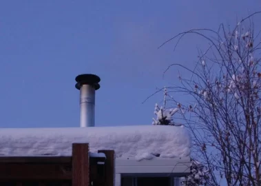

Last picture is the stack running with the cat engaged after my neighbor came over, I got a brown discoloration on the top one foot of stack I never noticed before.
How worried should I be?

The cap looks perfectly normal to my eye. What was the outside temp?

The last time I really "looked" at my flue I didn't notice any of that brown discoloration on the top section like I see today.

Get up there and take a look when you are able. But, you aren't going to find any damage. It would take a full on flue fire to damage your pipe. It's gonna be fine!
I'm with BKVP, I've also seen sparks make it into and out of my cap with the bypass open.
I've also seen several times where the cap has been on fire but not the flue. Sparks make their way through a relitively clean flue and into the dirty cap, a small fire breaks out for a very short time.
