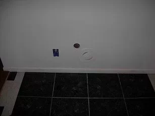

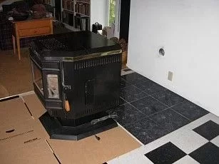

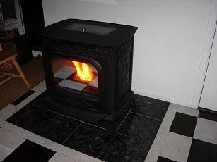

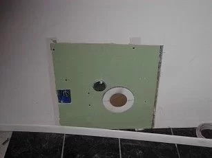

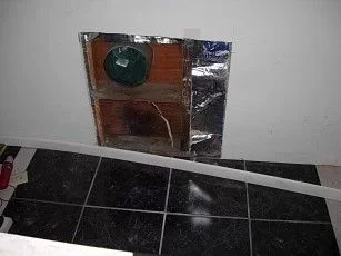

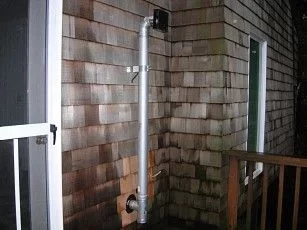

I just replaced my 1991 Whitfield Advantage II with a Harman XXV.
It required moving the flue outlet, electrical box, and having an outside air opening.

Very nice. Those XXVs are really pretty stoves.
Enjoy!
Thank you,
Now all I have to do is figure out how to best operate this sucker, my old stove was all manual, it worked OK until the $400 control board quit. That's when we decided to get a new stove. My wife picked the XXV. :-)
