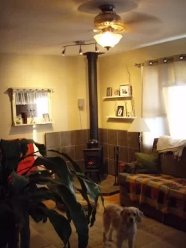

Greetings everyone. I've been lurking around these forums for a month or so now. I have been doing my research and decided to get a new Jotul 602CB to install in my 850 sq ft house. So far, it has been AWSOME, especially since it has been soooo cold this week. As I type this, the living room is 79F....NICE! I installed it with a new Selkirk metalbestos chimney, straight up.
Only minor issue I have right now is that the air does not seem to make it all the way to the rear of the stove, as I continually end up with large coals in the rear, and fine ash in the front of the firebox. I have a thermometer on the top front left of the stove, and it seems to be most happy 450-550F.
Anyways, who else has one? Any tricks or tips I should know about?

Welcome and congrats on your new Jotul!
It looks like it is a real nice install. I always wanted one of those for a fireplace in my living room. Let us know how it goes. as far as your question goes, some Jotul CB owners will chime in. My suggestion is to try to burn it just a bit hotter.

Wow, really pretty set-up. I like that stove a lot. No suggestions, really. My 400 likes to burn hot, and the more seasoned the wood is the better. Good luck

I really like your set up, it looks great! Congrats on the new stove, and welcome to the forum.

Thanks for the comments everyone! I took pictures during the chimney install if anyone is interested. Also, the wall protectors work amazingly well. It is interesting to learn about the radiated heat. The energy in this little stove is amazing. I plan to maximize the output as much as I can. I will be engineering some temperature data collection soon.
