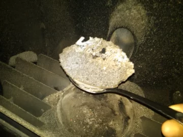

My NPS45 does not like Greene Team pellets definitely...!!!
geek
Feb 28, 2008
1,470
Central CT
Around end of last season one batch gave me clinkers but then they seemed to be "ok" on a different batch, Based on good price from lowes I bought 4 tons back in May.
Boy, I have to shut down daily to remove the massive clinker..!! I still have 2 tons, anyone wants to trade...:p

picture of the clinker...::-)

I just burned my first bag of GT 2 nights ago and got same result...solid rock in bottom of pot the next morning. It also took several attempts (e-2 code) to get the fire going initially and the heat was only ok...not impressed.

Burning the end of the '12 GT. Not as good as years before. Heat is not there and a bit more ash. Will only buy if there is nothing else is available and they are cheap.
We have the Napoleon NPS40, the freestanding version of your stove. I'm looking at the back of your firebox, around the pellet chute opening. I don't mean to bust your chops, but based on our experience, you're burning dirty. Black soot, daily clinker... how does your glass look by the time you shut down to remove the clinker? Is it light brown, light gray or is the soot deposit on the glass black as well? When was the last time you cleaned out the exhaust vent side of the stove? It's not as easy with inserts, I imagine. We have a direct vent out the side of the house. I take the Shop Vac outside, remove the directional exhaust cap from the end of our vent pipe and run the long hose from the Shop Vac all the way up into the stove, vacuuming as I go. Other people here use the leaf blower trick (I have no idea how that might work with an insert.) Just a thought, before you start selling off pellets, try cleaning out the exhaust side of the stove.
