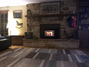

After burning a free standing Napoleon 1400 for years, we moved to a new home. Local dealer installed our family Christmas present today, a PE Summit.

Nice looking setup. Merry Christmas.

Now you have to do something with that cord LOL. I had same issue, but remedied when I installed new veneer over the existing brickwork. You know, you can also swap the electrical cord to the other side. Get yourself a hearth rug for the floor in front.

Thanks for the advice, I have an outlet on both sides but the one on the right is inside the cabinet so I’d have to drill a hole. I’ll definitely look in to moving it to the left!

Yeah, takes a bit of thought as to where to cut/drill etc to hide the wiring. I ended up running new electrical wiring from an outlet box in the adjacent wall, to the floor area, under the new stone veneer and into a lower old vent space from the heatform vent and added an outlet there. The blower cord was then run through a hole I drilled through the brick & masonry behind the insert side shroud, and into the same vent area & plugged into the new outlet.

Did you tear out a heatilator or set it inside the box?

Looks like the OP has a heatform style fireplace. Some folks call them heatilators, though that is a different company and design.

Makes sense. I see the two vents in his photo now. Mine has 4 vents, which I left in place & actually do work still, Cool air in bottom, warm out out top.

Just set it inside the heatilator box.... tearing that out would have been a major chore and likely ruined the hearth. Luckily it was plenty big enough to accommodate the Summit.

There some pieces of carpet covering the vents on the ground to stop the draft when not in use. I was wondering if I should remove them so the stove can pull air through them.... sounds like the answer is “yes”.

Why not, take the free circulation.
