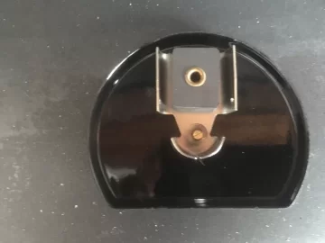

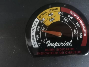

After getting many suggestions and advices, thank to all of you, I figure that my gauge temp became inefficient I have to say it was 20 years old. It was just not getting higher than 400F. Anyway problem solve . I got a new gauge Imperial that has a different system and is more realistic with the reading. I load yesterday , put the gauge on the top of the insert and after an hour of burning, I got a reading of 625 F. It ran for about one hour at that temp and it cruised at 500 F for 3 hours and then slowed down to 300F after another 3 hours. So , I think all is fine and I am getting more accurate reading. Regency claims a burning period of 8 hours and that is close enough for me. A few pics , back and front of the gauge. Home Depot , $28.99.

This one is for a single wall pipe, you mentioned you put it on your insert:
At the bottom of the page: "For single wall pipe only": (broken link removed)
Sounds like a good one, just the optimal range should extend to around 700.

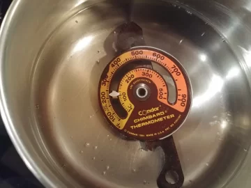

I have a condar pipe magnetic gauge (chimgard) that I have on the stove top. Boiling water test came up with right around 212f. I also ignore the color codes. I don't know for sure, but would suspect yours would be similar.
  • [Hearth.com] My problem was effectively my Temp gauge.
Reactions: albrown60
