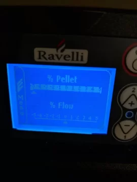

I was actually a little off on what I said my settings are so I snapped a pic, These settings work for the pellets I burn( all hardwoods ) but may not for what your burning.

The pellets I'm currently burning are AWF hardwoods they have a lot of smaller pellets in the bag that's why the pellet setting is so low, with longer pellets that setting will be bumped up a bit, the flow setting I never need to change.
Do you mean pellet feed at +1 and air at +2?
