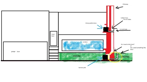

I bought a Harman P35i for a split-level home where one side of the house is halfway in the ground. I called ion and told them about the smell they said it is "curing" so I left it on the highest temp for longer than 24 hours. I don't think this is the problem. I think the problem is if I close all of my windows and screen door there is a smoke smell being distributed from the distribution fan. My father told me that our second-level pellet stove has an air intake hole that is drilled through the bricks and leads to the outside of the chimney but there isn't one for my bottom level. The fireplace is in the ground since it is a split-level home and I cannot get to the same level as the pellet stove for the air intake compared to the top-level fireplace. Do I need to make the intake for the ground fireplace to be as low as possible? Please look at my crappy picture.

the problem is when the pellet stove is burning the distribution fan is distributing some weird smell into my room. When I open the windows in my room and screen door the distribution fan is no longer distributing this weird smell. I do not have an intake hole for air as I do for my envoy pellet stove. Where is the combustion fan getting air from.
It draws air from Your room. Check your heat exchanger tubes for cracks. Silicone all joints on the exhaust vent pipe.
My room is pretty well sealed so where is the next place that the combustion fan will draw air from? Will it draw air from the chimney at the top?
If the chimney install was done properly, no. it should be sealed. If not done right it probably is. Does the chimney liner go all the way to the top with a rain cap?
Yes, it goes all the way to the top. and the cap is sealed with silicone with what I saw. Again when I have the windows and screen door open the distribution fan doesn't have the smell it does with everything closed :/
