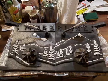

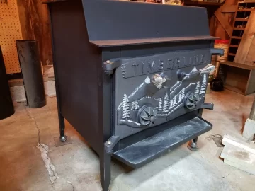

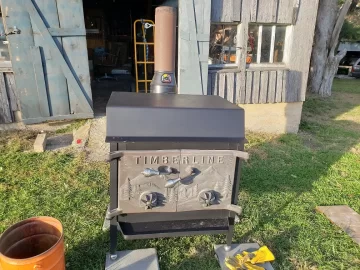

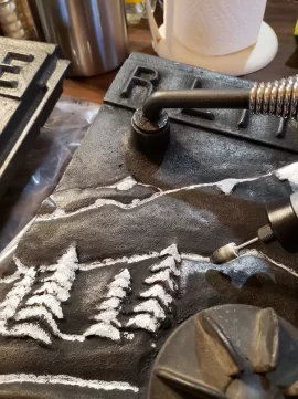

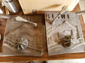

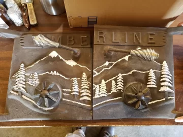

I should have taken more pictures of the surface rust before painting. Also had to install new fire brick. The stove, paint, polish, firebrick cost me a total of $400. I grew up with this model stove. Glad to have one back in the man-shed. Oh man it is definitely toasty now.
