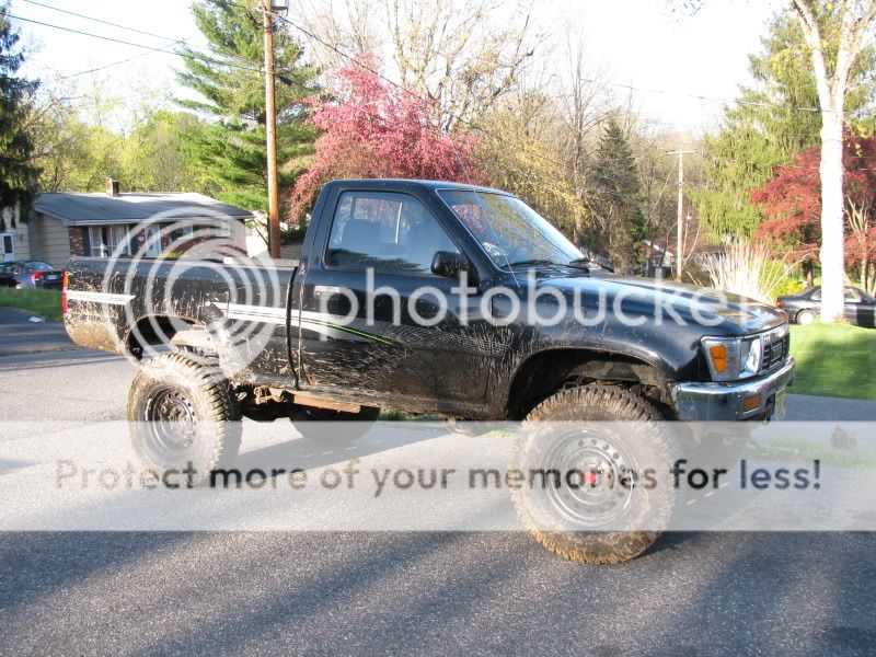

DONE! Did a marathon on Saturday before the big Easter festivities-tires, new shocks, full new exhaust (manifold to tailpipe), and a few miscellaneous items. In my excitement I forgot to take pictures of it before I got it dirty, but it looks better dirty anyway ;)
[Hearth.com] My Toyota woodhauler build
I took it out to one of my new cutting/hunting areas and really put the tires to the test. Even at a rock hard 65 psi (which is good because I can't air down and carry heavy loads) they dug in, bit hard, and grabbed on all kinds of terrain. I'm still running open differentials at this point-I can't even imagine how much better the traction will be once I lock the rearend. The first project will be gathering some rock for the new outdoor firepit I'm planning. My 2012-2013 wood supply is looking pretty good so I'm going to take a break from scrounging at least for a little while.
