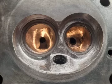

My truck has been randomly overheating for years. No rhyme or reason, just overheated out of the blue at random times. Last year it finally got bad and that was that. We parked it and used the car/small trailer for everything until we could fix it. We tore it down this week and found a broken head bolt that caused the head gasket to fail. It took 14 years with a broken head bolt for it to finally let go completely! The guy I got the truck from (14 years ago) told me to drive it to the scrap yard, but I did some fixing and ran it hard this whole time. Best we can figure is they tried to fix a head gasket and broke a head bolt and that made them think it was junk, so they slapped it back together. Half the gaskets were old/broken/leaking.
We ported the head, removed the broken head bolt, and put it back together. I drove it around for a while today to make sure it was fixed, and it was perfect. It stays nice and cool now, and sound a little different too. I'm giddy like a kid right now, just waiting to haul more wood. It took a lot of trips with the small trailer this last year, compared to using the truck. The little trailer only holds about a face cord of wood, while the truck will carry whatever you can fit on it. It's at least a 3-to-1 difference. Luckily this last year was almost entirely local wood, within a few miles of the house, so the fuel cost of 3x as many trips was not bad at all. This year some of the wood is still local, but a lot of it is 10-20 minutes away, so the truck is going to save a bunch of time and gas, especially since a lot of it is oak. My little trailer can't carry much oak. 😦
My son is itching to get the flatbed fixed up too, because that will carry at least a cord, maybe a cord and a half. That would make 2-3 cord per trip. We'll have to pack a lunch. 😁 We'll also have the log wagon for bringing home mill logs or log length firewood.
Here's a picture of the head porting and a little snippet of the truck taking off up a hill today.

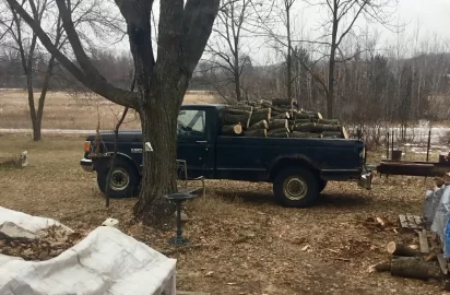

It's a 1991 f250 with the 300 inline 6. It has 6k springs and a full float sterling axle. It's a 5 speed manual, currently with a mazda transmission, but I have a zf5 to swap in this summer. I want the low 1st and reverse, but I am unsure how the shift spacing will feel, so I'm just going to try it and see if it works. The odometer shows 79,000 miles, but that could be 179, 279, or 379. It showed very few miles when I got it, but it had most likely recently rolled past 100, 200, 300k. I drilled the rear drums and removed the proportioning valve for better brake pressure. The valve was cutting rear brake pressure at ~200 psi, which leaves the front brakes to to all the work, but most of the weight is on the rear axle when loaded. The brakes work very well now. It's a great wood hauler.
I don't have many pictures of it, so these will have to do.

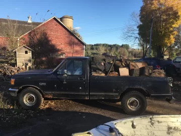

This is a load of oak that is partly unloaded already

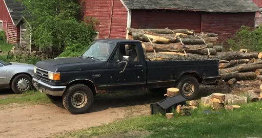

Another load of oak

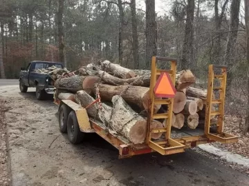

Several dead oak trees from the same tree service (I think this load was around 20-22k gross)
Congratulations on getting the old truck going again but...
Please do not do this! That Ford is likely rated for no more than 14,000 or 15,000 lbs. combined weight - and that would be with a load distributing hitch.
Yes, I know. You've done it like that for years. No problems. So had a family member, and he is dead. No one saw the accident, but it had all the hallmarks of uncontrolled trailer sway that took him off the road where he overturned. He had made that exact trip with that same truck and trailer and that same load of firewood across those same roads dozens and dozens of times.
Trailer sway is a result of improper loading/weight placement on the trailer. I make sure to have plenty of weight on the hitch. The factory ratings for this truck are out the window. Those are legal suggestions from scared lawyers. I don't fly down the road at 70 mph with loads like that. The SMV sign on the back means I am traveling at or below 35mph. I'll do 55 with a load on the truck, but no faster. I don't like to run down the road at more than 2k rpm. I keep a long following distance, slow down early, I don't fly through turns, and I stay away froom steep grades with heavy loads. Growing up on a farm with loaded wagons teaches you a lot.
You need to be smart hauling heavy loads for my brother was a truck driver and wonderful at it. Why just a few days ago I picked up my computer that was being repaired and there was a this car hauling trailer that went straight across the road and the trailer was "sideways" with two cars that were tumbled because I guess of the wind. We were all scrambling to get out of the way and figure out which "direction" to go--felt sorry for the driver of that big rig...So be safe everyone..clancey
Reactions: salecker
I completely agree with your sentiment. But you max weight is low the truck alone is roughly 5000lbs trailer can be 10000 max and payload max of about 2600. So total gvw of 17600 if it's an hd version. But your right it still doesn't add up to the 22000 stated. I would haul that much within a mile of my house on the small low speed back roads. But definitely wouldn't take it further or at much more than 30 mph.
Reactions: clancey
Experience with heavy loads will keep you safe.
It's a part of life up here.And the roads are not flat pavement.
I have pulled a tandem trailer behind my 1 ton truck with a combined weight of 24000 lbs +
Not an everyday load.But sometimes you don't have a lot of choice.
My license is a Class 1,i can operate anything with wheels on public roads.Been hauling with low beds since i was 19.
That trailer was not an everyday load, but the other pictures are. The plan that day was to pick up two oak trees, but the homeowner decided to cut all the dead oaks while the tree service was there, so I took 'em all. Top speed was 30-35mph. It doesn't bother me to pull loads like that, you just have to be careful. I cringe when I see new trucks pulling huge campers down the road at 60-80 mph. I don't think that is anywhere near safe, especially when the drivers have little or no towing experience.
