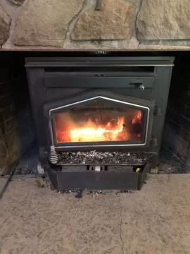

Anybody know what this stove is? I’m really most interested in the capacity as I just bought a 2.6 cu ft Regency I2600 and I’m wondering how they compare.
Thanks!

Crooked Chuck. But that's just his surname.
Looks like a Tiffany to me.

Looks like an older Haugh's Frasier Elite, with that distinctive door. It was a small/med insert capable of heating about 1200 sqft, 1.75 cuft firebox if memory serves. Its missing its surround. It was a non catalytic steel secondary burn baffle system. A good stove, nothing spectacular. Your new hybrid cat/air tube system on the 2600 is very far superior. I recently have begun selling Regency and Hampton and are onboard the train. Their original hybrid design lacked some robustness in the cat engagement frame, but the new design seems to be just great. It has a sec air tube to get the process going and the cat element finishes the job, high efficiency and still a pretty burning stove. You have a superior stove there. Good luck with it. It should be superior too, as it is a high end unit price wise as well. The Hamptons' castings (the cast side of Regency) are amongst the best quality I've ever seen....

Jimbob. Earl doesn't have the fancy glass.
Someone who actually knows something about stoves should be along with a less silly guess soon. ;)
