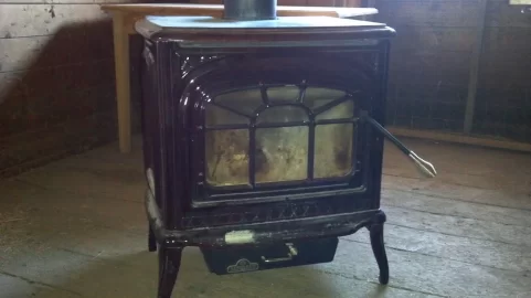

That's what I am figuring. Has there been any changes to the stove design that anyone is aware of since 2005? The door in the sellers picture looks different than what is on the Napoleon's website.
Not sure. I don't recall a door change on the cast model. Is this the 1100p or the 1100c? Can you post the picture? Also, does it include a blower? That's not a show stopper, but will add value.
I do not know yet if it includes a blower. I have tried uploading a photo. I appreciate the help begreen. Do you think any of the required clearances have changed since 2005? Thanks.

That looks like the more traditional Napoleon sunburst door style. They still use it on the 1600c.
The stove looks well used so I would want to look at it cleaned out and vacuumed so that it can be closely examined. The main areas to examine are the secondary manifold, but the entire interior of the stove should be checked out for cracks, warping, broken or missing firebrick, etc..
Thanks. So the door style has changed then I guess because this is the 1100c not the 1600c.
Seller says it has not been used for over a year and is real dusty because they moved.
My copy of the manual dates to 2010, so I can't say if the clearances have changed. The clearances will be on the UL plate on the back of the stove.

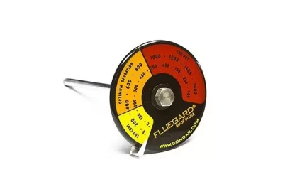

Oh, speaking of flue temps, you will need a prob thermometer installed into your stove pipe above the stove as this being a cast covered stove, the magnetic stove tops ones are useless.

Thanks HM! I really appreciate the advice. I have not seen a probe type thermometer. I will have to look into them!
$25 bucks will give you peace of mind you are burning your stove properly until you get used to it. There ay be other brands and the face on mine is a little different but here it is:
