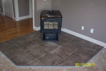

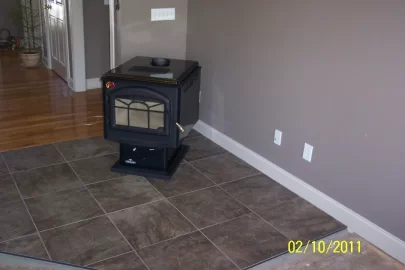

I attached a few pictures of the stove before flue install, and one of the very first break-in fire. I will attach a few more pictures later of the final install, with the carpet laid back in position also. Thanks for all your help, as I think I made the right decisioin.
PS: Wonderful buying experience with my dealer. Got it thru Obadiah's, and Woody is so great to talk to on the phone. He answered all my questions and more! I would HIGHLY recommend them!

Good to hear it's worked out well for you. Thanks for posting the follow-up pictures. That's a serious heater. It will make a big difference when those arctic blasts roll in. For fall and spring burning, just do smaller 3 split fires and let it go if the house is comfortable.
Congratulations on the new stove. It is very nice looking. I'm in the same boat of installing a new stove and the temps outside getting warmer. I guess that's the way it goes. Enjoy

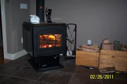

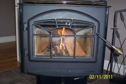

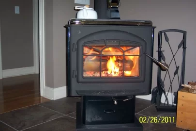

Here a few more of the fire we had cranked up on Friday evening, and with everything back in place.

That looks cozy. Try loading the stove with the wood parallel to the sides of the stove for a few loads. I think you will find it burns a bit better.
Nice. I love that stove.
For $50 they sell a cooking trivit which you can sit your humidifier on without scrathing the brass on the one you have. But its not as pretty.

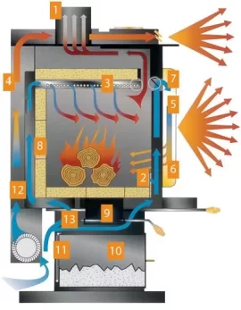

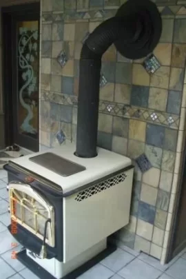

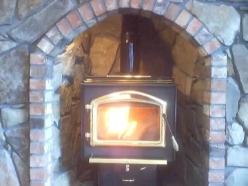

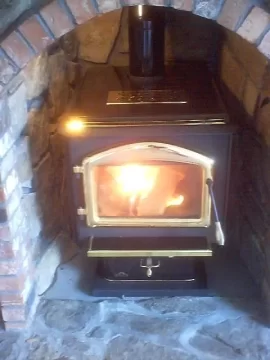

I've added a couple of pictures of a install that I did in a all masonry Alcove. I love doing rock work! Anyhow this is one type of installation where a convection stove really shines. If this was a radiant type of stove, most of the heat would be absorbed into the masonry where it would essentially be trapped. With a convection type stove, that air flow is actually enhanced and distributed into the rest of the home through the natural convections properties in every enclosed structure. Just take a smoke match and light it and follow the smoke and it is very easy to see where the convection currents are. They generally go one direction near the ceiling, and the other direction near the floor.
Now this job started as a rather large inefficient fireplace that is on a outside wall between the house and attached garage. The problem with this type of installation is the masonry acts like a big heat sink sucking the heat out of the home through the masonry. This is why whenever I design a masonry type heating appliance, I will encourage the client to install it as close to the center of the structure as possible. This takes maximum advantage of that heat sink property and then that masonry structure acts as a battery, absorbing the heat into itself, then radiating it gradually into the structure over time.
In this case we rebuilt the fireplace into a Alcove and then installed a Napoleon 1900 in it. It has worked very well, the customer was thrilled and they could now use wood to heat the entire 2000 sq ft home. We did this installation over 10 yrs ago and everything is still working great.
PLEASE NOTE*** I have saved a few folks from burning their homes down trying to do this kind of installation using wood framing and cultured stone or brick. As a professional firefighter, I have seen first hand what happens when you do that. Trust me, it is NOT something you would ever want to experience firsthand. So if you are planning something like this, it must be properly designed and engineered. If you are unsure of what your doing, don't just hire any contractor. The two homes we saved this year, were both being built by professional contractors. These guys were simply not experienced in this area, they did not understand the dynamics of heat transfer and how it can affect a wooden structure over time. Consult with a engineer, or hire a mason to build your Alcove who has experience with fireplaces. If your short on money, or a do it yourselfer, call your local fire dept. many members there are also contractors and will gladly help make sure you don't burn your home down. Lastly, there is great info right here on Hearth.com under K-Values. All the formulas are posted so you will know what to do.
I also have done a series of You Tubes on this subject, just go there and type in Obadiah's Woodstoves and you'll find our channel. We will do anything we can to help you be safe and warm.
Burn On!!!
