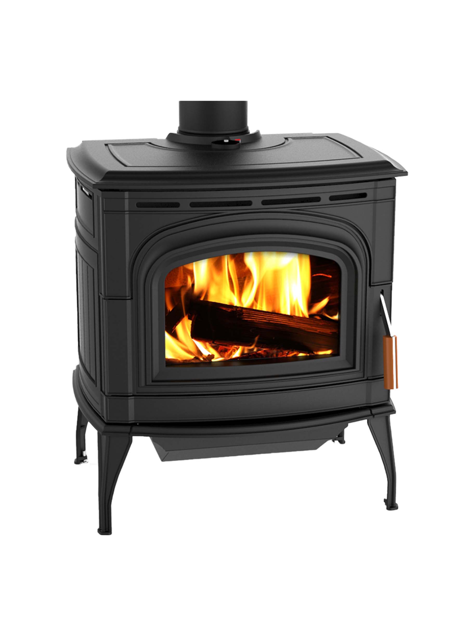

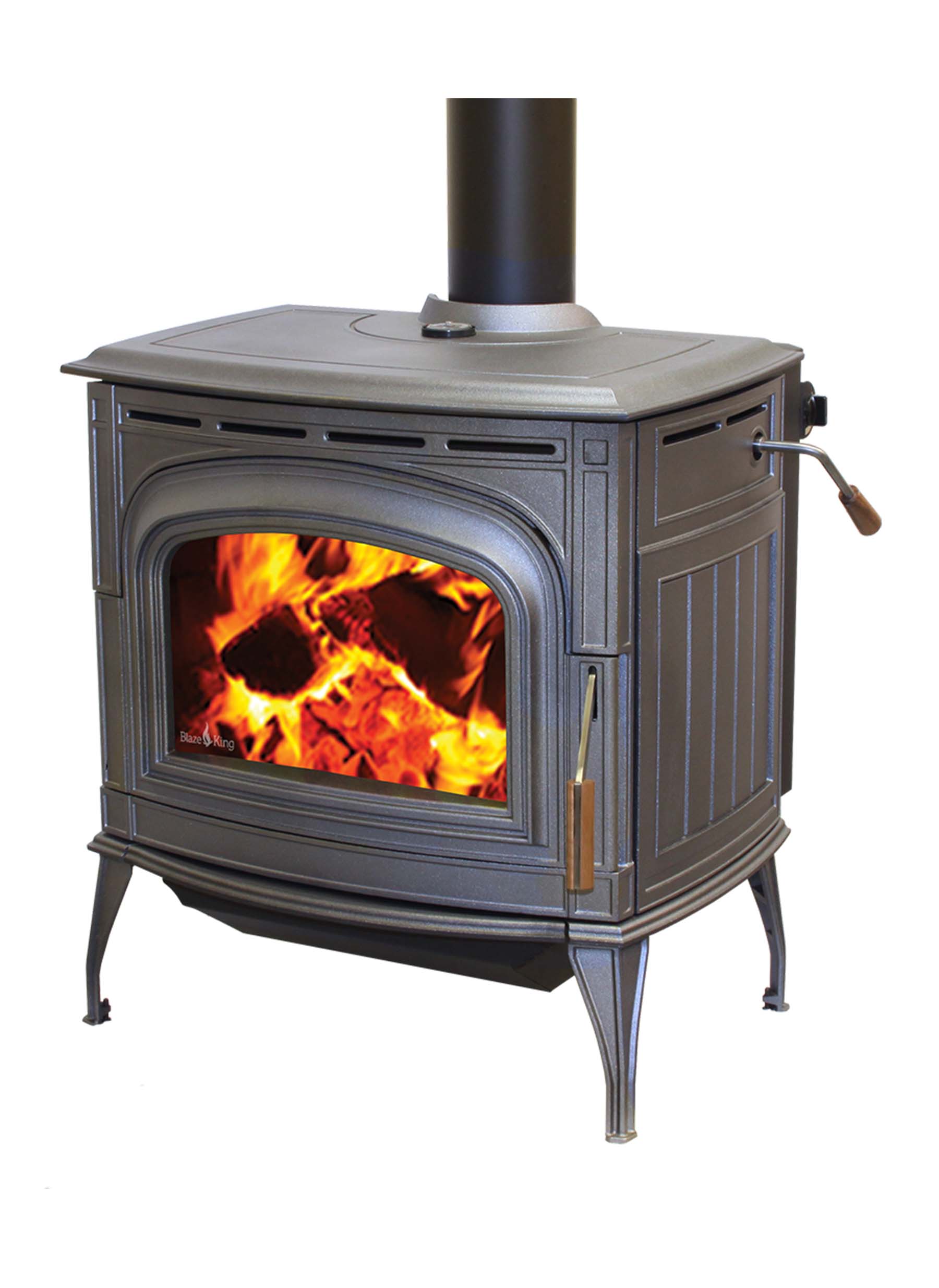

Hi BKVP, I've heard you are the expert on Blaze King stoves. In a comment above it was said, "If you go BK, get the 30 models. The output is more or less the same but the fuel tank will last longer." But I've been told by the dealer near me that my 1100 sqft home is too small and they recommend the Ashford 20.2 instead of the 30.2. I attached a sketch of the house layout. I'd love to get your guidance on this before I pull the trigger.

(speaking when I should stay shut...)
The overheating argument (small house argument) has to do with what the lowest rate is that BTUs are produced in a stove. Too many BTUs and you cook yourself out of the home/room.
BK says for the 20.2 models:
Constant Heat Output on High
28,355 BTU's/h for up to 8 hours
Constant Heat Output on Low
11,342 BTU's/h for up to 20 hours
And for the 30.2 models:
35,980 BTU's per hour for 10 hours
11,993 BTU's per hour for up to 30 hours
That is a meager 5.7% difference in BTU output.
Meaning if one overheats you the other will too. And if one (the 20.2) does not, the other will not either. Yet the other (30.2) will be able to keep that output for 50% longer time (because of the 50% larger firebox = 50% larger fuel load).
Of course these low outputs and long durations are all dependent on the specifics of the install (chimney); they need to meet what the stove needs, in order to be able to perform as specced.
As an example, my 30.2 model loaded with red oak (admittedly a tightly packed "stove tetris" load with splits that did not have any bark or sapwood, only the highest BTU heartwood) took 36-37 hrs before the catalytic combustor cooled down below its active zone.
A chimney that's too drafty (tall) will decrease that time (because more air is sucked in, so the burn rate will be higher, given that I had the air as closed off as one can in this stove). A chimney that's too short will make you need to have the air farther open, which may result in similar times, but is generally not ideal as smoke roll-out might happen due to insufficient draft.
Anyway, see the numbers above. If you have the physical space, and three and a half 1.5 kW plug-in electric heaters (putting out a cumulative 12000 BTUs per hour) is not too much for your home (!...), these stoves will not overheat your place.

Thanks for explaining. I have to agree with your reasoning, and if I understand correctly what I'm reading about catalytic stoves, I don't have to worry about creosote buildup even with the low burns.

What he said! The larger fuel tank of the 30 just means longer burn times between reloading. Being a steel firebox with cast sides, you can glide along with convective heat... you'll want to burn on high periodically to keep firebox clean of deposits.
