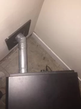

Ok venting is a 3" that runs about 1.5 feet off the stove then bends at a 45 degree angle to go out the wall because the pellet stove is kitty cornered in the room, there is a clean out t down low and then the exhaust runs about 7 feet up and at the top is a 90 degree elbow away from the house and then a vent on the end.
  • [Hearth.com] Napoleon nps45 problem!!!!!
Sounds okay to me. Are you sure it's totally clean? I agree that is sounds like insufficient airflow - just need to find out why. Perhaps there's a hidden clog somewhere in the stove combustion air/exhaust passages. That's assuming the exhaust fan is working properly, as noted above.

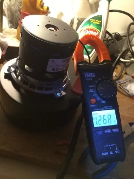

It is possible but may be due to a damaged Triac on the control panel. Take a voltage and current reading with the stove on high, Then connect an ac line cord to the blower and take a voltage and current reading. If it is greater with the test cord, then you may have a bad control panel.
I use a good clamp on meter from Home Depot. For current only one wire should go thru the clamp. See pics below.
