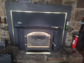

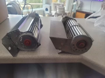

Need help with where to get replacement blowers and starter kit for Napoleon wood insert. I have looked extensively online. Blower is a QLN65/0018 A59. Not sure if it is a model 1402? I purchased a blower kit online that was supposed to be compatible but it didn't fit. The one I need is on the right side in the pic. Help please!

Without having the blower in hand I am wondering if the stock replacement blower does not come with the mounting base and nose shroud that your blower has pictured. If so, those pieces may need to be taken off the old blower and mounted the same way on the new replacement blower.

I can certainly remove the mounting base and nose shroud from the old blowers and install them on the new ones.

Yes, they come in kits, designed for their freestanding stoves in which the speed controller is mounted on the fan housing enclosure. Thermal snap disks are generic. One just needs to match the temperature range, case style, and connectors.
