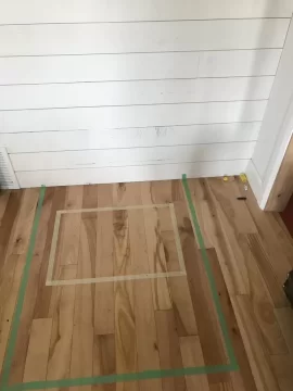

I’m looking to heat around 1500 sqft , it’s a wide breeze through area it will be okay for burns. I have it taped on the floor and have piles object s for visual effect , it will work!
What stove model was the floor taped out for? Can you post a picture of the taped out area?
It’s taped out for a regency F1150, or the cost LE1500 Pacific energy. Both were the same if I remember but neither are cast iron or have a cool top: my only option close to that they had jotule F 602Vs but it’s a tiny heater. I’d like to hit around 1200 to 1500sqft heating….. I love the jotule look best😢

Unless the wall behind the stove is not studded or entirely non-combustible, the rear clearance requirement for the stove needs to be factored in addition to the actual stove depth. Check out the Regency 1150 for a shallow stove.
Oh lol the floor is taped out for the regency f1150. It’s okay for dimensions but I want cast iron and more of a Jotul look or Morso. Just hoping there are some other brands that would hit the spot

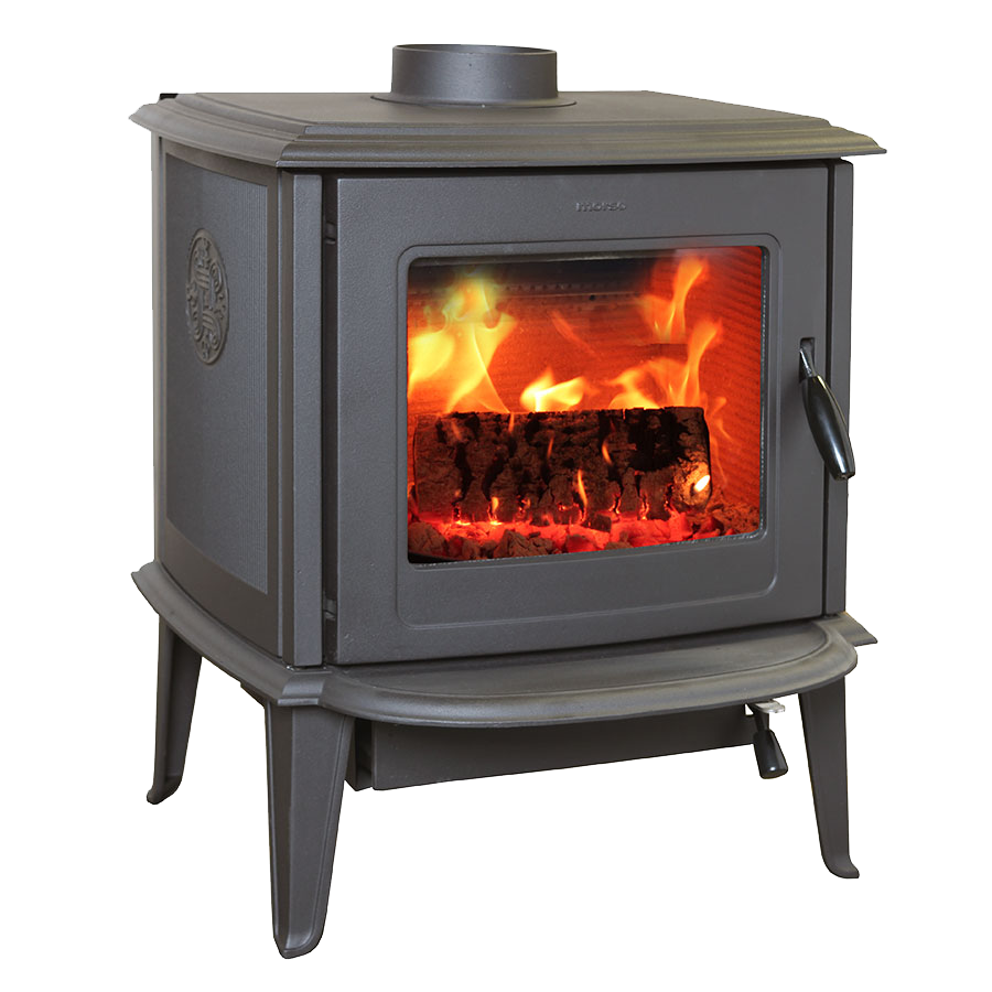

The Morse 2B is only 13" wide, but has a 26" side clearance requirement. The Lopi Rockport and Drolet Capetown may be too large. The Morse 7110 might work.
I love the 2B but the side clearance is not going to work. You’re right about the 7110 could be good, I’ll have to check the price
