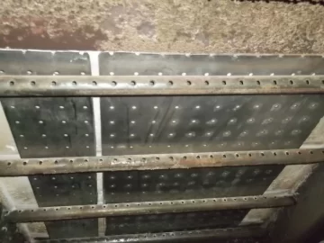

I decided to make a small mod to the 30 in an attempt to preserve the one delicate portion of a perfect design - Baffle board strength. My goal was to go simple and just run it this way in 2014/15 as a test. If need be I will mod my mods but the plan is to limit the number of nicks and scratches(an hopefully any damage) to the exposed baffle boards and preserve their longevity. I try to be as careful as possible when loading and poking around in the stove but inevitable that one weird split or inadvertent jab with the tool will bump the boards so this was my first try at circumventing the issue. The material is just some 1/8" or so stainless shelving material I had at the shop plas cut to fit without much effort. It is in two pieces to get through the door and does not perfectly cover the whole surface but if it survives the heat it should do what I am asking without any compromise to design or performance. My only real concern is warpage - of which time will tell and it can easily be removed or changed out.

i'd be curious to see if that SS warps or not. Those soft baffles are one of the reasons i steered away from buying one. Doesn't seem like a very good design.
KS - I get your reluctance and it is a small price to pay in regards to longevity but to get a stove of this quality to the consumer at such a low price there are certain things that need to be compromised for sure and this is really the only area that I feel is not equal or better than the counterparts costing 2-4x as much - so a small price to pay. Most just leave them as is and never have much trouble but the replacements are not cheap and would be a pain mid-season so I just thought I would try this and see what happens. I am 50/50 on if the stainless will survive the heat but with the boards on top and 4 tubes I think there is a good chance it survives. If not - I will come up with some other trickeration to play with. I have run the stove for 2 seasons without any trouble but I am also a tinkerer so this was my summer mod.

I tried the SS a few years ago. Stuff warps and pushes the boards up. Then you get the privilege of having to let it burn down to take it back out.
regency's are cast to. But really most of the time they hold up pretty well and that ss plate will warp for sure like bb said i have a feeling it will cause more problems than anything else if it warps bad it could even break the board

Well B Bart is the answer. Tried and failed -thanks for the update long before I melt those suckers.
