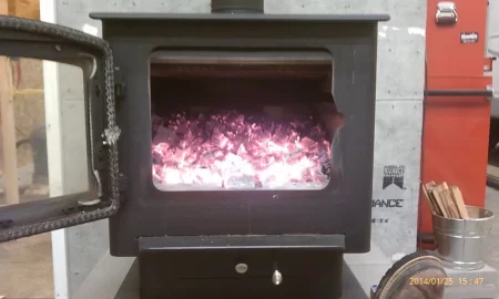

I am one that overfeeds the stove in order to keep the room temperature up or rising. I use it in a well insulated but large shop and run it at maximum safe output which means it can coal up regardless of how dry the wood is. So yes, it is certainly possible but this is not unique to the NC30. It would happen with any woodstove being run hard.
It isn't a very deep firebox, as in ash storage depth, but since it is such a large firebox it can hold a lot of ash. I do NOT use the ash plug and pan, just shovel it out. The ash drawer, like many brands, is extremely small and almost totally a worthless decoration.
The NC30 is well built, cheap, and most importantly it is BIG.
