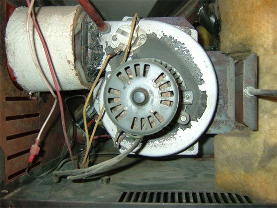

Thanks for the links, maybe I will have to replace the whole blower unit as there are no bolt holes to just bolt up a new motor like the one on the link pic?
This is what I have now, doesn't look anything like the newer stuff.

You will need to change your blower housing,has never been upgraded.Call/look at-Wood heat stoves and solar, part #10-1113-epp or 12056010.
I put one of these in my stove to make cleaning it easier. Looks like it will work in Your application.

Picking up the updated blower housing with motor today, hopefully in a few hours it will be purring like a kitten and getting the air its been needing.

Back up and running after an hours worth of work, stove hasn't run this good since i bought it 2 yrs ago. Re-set it to the specs per manual, amazing how good it runs now with the proper amount of air
going through it!
