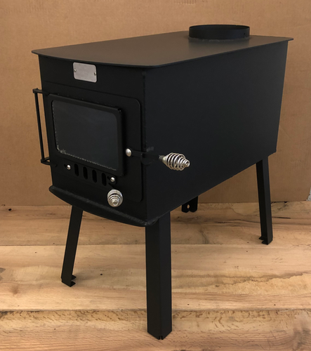

So I was watching a video of the Survivor Grizzly. It seems it was going for $179 a year or 2 ago. Now it is hard to find, and $459 on ebay, including flue kit and everything for a house. I was about to get it and cut out a hole in the door and buy glass for it, like someone did in a video.
One other guy mentioned he chose it over the northwoods, which has glass in the door. Hold on...what is northwoods? My NEW STOVE!
What is it's intended use? I am a bit sceptical of it's specs. It claims to be made of 1/8" plate. And roughly 24 x 12 x12 and only 45 lbs? It just sounds like allot of steel for not much weight.
I would like to do some winter camping here in the south. Until then I'll break it in out in the back yard. I'll measure the thickness with a caliper when it comes and check back for sure.
