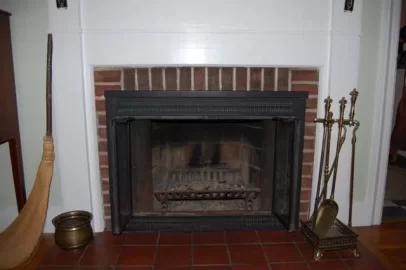

Hi folks,
I'm trying to enter the world of pellet heating. An insert will work best in our house for a variety of reasons, but I have been stymied by the small size of my 1940s fireplace. The depth is okay (16.75") but the width at the back is problematic - 18" at the back, 22" at 12 inches from the front, 20.25" at 14 inches from the front.
I found the forums in my search for options, and they have been very helpful, but not much stove specific discussion. I am wondering if people have comments on the Enviro Meridian vs the Napoleon NP145 - both seem viable. Reliable? Ease of cleaning?
Any other recommendations are welcome. We started looking at Harmans at the recommendation of our chimney sweep, and liked both function and ease of cleaning, but our fireplace is just too narrow toward the back.

We do have a hearth that is even with the floor, and have considered a standalone stove. Advantages seem to be power and perhaps ease of cleaning and repair, and it opens up some options we like. The complications are the need to extend the hearth (to do it well from a design perspective probably means cutting out some flooring and retiling) and the floor space of course. The fireplace is oddly situated in the room - it is a center chimney, but placed to the right of the room right next to the door to the kitchen (you can see the doorframe at the right of the photo).

One more piece of information. I talked to a dealer today who recommended adding a 1 to 2 inch fabricated steel extension to the face of the fireplace to allow the insert to mount out further. Is this a viable solution or nuts? Something that would pass code or create other issues?
I'd go with the Meridian myself, altho the Napoleon is a fine heater too. Enviro just chopped price of Meridian a few hundred dollars too, that might help. Meridian been around many years, good burn engine. The new cast iron model fs is out, the insert comes out later this year. Putting an extension on the face of the fireplace to make one fit is ok, would look better too rather than having that gap at the opening.
