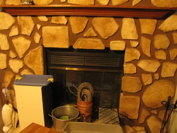

Ive not really been looking at inserts as Eff. goes Dwn the wall my Dbl fireplce is can be modifyed for a stove easily I will post a pic My FP is a Preway Fp 50 built in older members may know of it

a pic [Hearth.com] Need a wood stove for a drafty home 1600 Sq ft

I have done exactly what you are talking about a few times. I removed the fireplace and all the framing, put Dura-Rock and tile on the walls. I removed the fireplace flue, and used the same roof penetration and flashing for the new class A chimney.
If you don't do an insert, the chimney is not allowed to be used for the woodstove. If you went with an insert, a SS liner could be dropped down the chimney. I would highly recommend that you go up with the chimney as opposed to out the wall with a Tee. In Modular homes, it's hard to get the flue high enough to draw good. Going straight up would be best.
