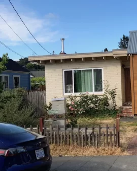

I have a Morso 2B standard. Photo attached. I bought it from a well reputed Morso dealer and had them install it. The original brick fireplace brick chimney is 11 feet tall. When it smoked a lot right after installation I had them come back and add the 3 foot extension, so now the total flue from stove to cap is 14 feet. I see now that the manual says 16 feet, but as I had the Morso dealer install it I just trusted them.
The temperature yesterday was 56 outside, and 68 inside so I lit the fire. I see now that it might do better in winter, where we are usually in the high 40's.

The company that installed it put a single walled flexible chimney liner, and then a 3 foot stainless pipe to give me the 14 foot total. Still, if I don't get better results in the winter I might go up there and add a couple of more feet. They told me that 6 feet would be too much for a single walled pipe coming out of the chimney for creosote buildup, and they recommended doing a 6 foot double walled, but they charged me $350 to put up this 3 foot and it will cost $1,200 to go with the six foot double walled.

So you've got quite a few things stacked up against you getting a good draft. Very minimum, I'd try to get the entire liner insulated and bare minimum 3 ft exterior insulated flue, if not the 6ft insulated section. Believe that would get you close to the minimum required flue, as mentioned.
