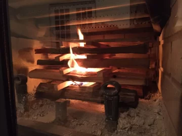

I could use some advise on this topic. My objective is to learn how to go from a cold start to cruise mode in the least amount of time as possible. Right now this is taking me almost 1.5 hours to accomplish and I'm thinking there's got to be a better way. I remember reading somewhere on here that someone was accomplishing this in about a half an hour.
Here's my current technique:
I'm making a fire from a cold start using a nice amount of dry kindling and a Rutland fire starter. I leave the door cracked open for about 5 minutes and then I close it. My system has great draft, the wood is bone dry and I have no problems getting a beautiful fire started. Once I close the door this will burn strongly for at least 1/2 hour. At that point I usually throw in 1 or 2 small splits to keep building heat. With this method it is at least 1 to 1.5 hours (total elapsed time) before I am comfortable raking the coals forward and loading 3 medium splits. Then it takes 15-20 minutes to dial down the load of medium splits and achieve "cruise" mode.
Sometimes this 1.5 to 2 hours is too long given my schedule and the timing not allowing me to make a fire when I would like to.
I would love to learn how others are starting their stoves from a cold start. How much wood do you load? What size wood? What type of fire starters? What air settings?
If anyone has any pictures of their cold start loads that would be awesome! (I've attached a pic of my cold start load of kindling)
Thanks!

You need more wood in there to burn and transfer heat to the stove. I like using softwoods for this since they light off so fast and burn quickly.
Pack the stove with more fuel and it'll heat up faster.
Load the bottom half to 2/3 of the stove with dry kindling and place small splits on top. Once the flames start licking the top and you get the 1st hint of secondary action start cutting the air down so the heat does not go up the flue. The heat then builds up in the firebox and eventually starts radiating out the sides of the stove. You'll burn through this load quickly, but will heat the stove fast.
Lots of variables but I have a 2.3 ft firebox and here is how I get it going. 6-8 sheets of news paper. one medium size piece of kindling diag across the dog house front to back corner. other small kindling across the medium piece then about 3 small splits and 3 medium splits stacked very loosely. Firebox 75% full but again very loose. Light the paper and crack the door until I can see kindling is going then shut the door with primary wide open. Get coffee and when first cup is down, go back and check the stove. Normally after that 15 min first cup, I can shut my primary all the way down at it will burn nicely on that initial load for about an hour with stove temps climbing.
If it is a weekend and I am home, I just keep adding medium splits every several hours to maintain the temp I am after. On a weekday or at night at about 1:15 in, I put a very large split in the back and medium stuff on top and in front of that. Open primary for 5-15 min and then try to shut it down. If it looks like I am going to loose the secondaries, I open it up another few min.
In reality, I can normally get to an initial secondary burn in as little as 15 min but to get a large enough load going to burn 6 hours or so, you need the coal bed from the first set before you can load it up. My stove is 10 years old and I have not replace gaskets. I like the way it burns and like that I can close the primary down and have a nice secondary burn with no fuss and get reasonable stove top temps with no smoke from the chimney. I do have to be careful of not using too much of the hotter woods on the larger loads though. I had a few fires late this year that pushed 600 on the stove so will likely replace at least the front door gasket this summer. Let the learning curve start over again...
Sorry, I don't have a picture. I am not sure if you have primary air coming into the lower front but using a small split to elevate the initial startup load and include a couple of medium splits in the mix might get you going faster. I would never elevate the larger loads for sure.
Wood supply is normally medium to hot hardwoods dried at least 2 years.
Hope that helps

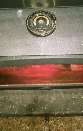

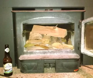

11:13pm. A flat split. A home made fire starter. Then kindling and a few smallish splits on top. Door open for about 30 seconds after starting.
[Hearth.com] Need Advice on Faster Startup Time
400° at 11:37 after the air has already been cut to 3/4 throttle. Time to turn it down to half throttle.
I added one split 90 minutes later to get me through until my last load of the night. 41° outside. Small insert with about 14' of uninsulated liner.

I would never load kindling as you did. You don't need all that air space, as you do for an outdoor fire. Just lay the kindling on the bottom of the firebox (or top for top down fire), making sure you leave a path for the doghouse air to get into your wood. You'll get better burns if you pack your stove fairly tight, and with the wood on the firebox floor.

I like your Lincoln Log approach, but maybe take a 1/3 less rows from the top and use those as filler in between the lower rows below, so now maybe an 1" between them. Then, get some good mediums with the space now left over and you should have a blaze in no time. Wow, from all that kindling I use maybe 6 of those and have it cruising in ~45mins. from a cold start. Oh yah, I use a 1/4 of a firestarter too.

Handy Daddy I'd take those sticks in the pic you posted and just simply drop them on a few pieces of crumpled paper...then top it off with smaller splits 2x4 sized and light 'er up.
Too much air space will in that kindling box structure will take a little longer if you desire a good cruising-range type fire in a short period of time.
