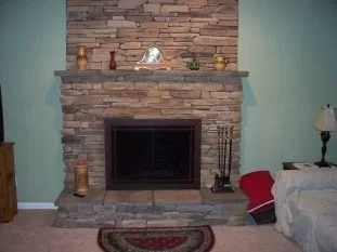

Thanks for your reply. This stove would not be used for 24/7 heating. Looking to heat about 1100sqft. Here is our fireplace that produces very little heat. My wife likes the hampton- enough said I guess. Thanks for the links as they are nice looking too.

OK, from the use you've described, the Hampton should work out fine. It's a beautiful stove and has a lot of happy owners. One thing to watch is the hearth extension requirements, 18" min. required.
Thanks, it appears I don't have 18". My hearth now is 16inches. I'm not sure how I could extend my current fireplace.

Don't let that stop you. Mostly what is needed is an ember barrier. A nice tiled or stone border in front of the hearth at floor level would look fine and is a relatively easy project. You could use 6, 8 or 12" tiles or stone, slate etc.

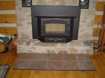

I had a Regency I3100 installed with new liner, labor, surround, my old insert taken out and the pad you see in the below picture for $3850 with tax. Take my word for it, you can make your own hearth extension. I paid the dealer $195 for the one in the picture and wasn't happy for it. I mean 10 tiles at $4 each and some adhesive and grout?
