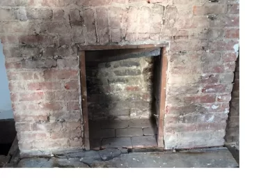

Hi All, We found this behind a plaster wall. We new the chimney was there, but the small fireplace is a nice surprise. We're thinking of lining the flue and getting some type of gas insert. The dimensions of the opening 20"W x 12"D x 38"H. Anyone know of anything that might fit? [Hearth.com] Need Advice Small Fireplace Opening

That's a great candidate for a rear vented freestanding gas unit like the Jotul Lillehammer depending on the depth of the hearth..... Very oddly shaped fireplace you have there. A Quadrafire Garnet or an Enviro Ascot would also do the trick, depending on how much square footage you were looking at. I haven't seen too many inserts that would entice a space like that off the top of my head
Thanks. It's a very old Victorian house. The fireplaces were all coal baskets. Every room has one. Some have been enclosed in the walls. This will probably be the last we make functioning.
