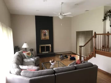

New to all of this. With all the talk of energy shortage this winter I was looking into a wood burning stove to help heat - and if possible - to cook on. I have an existing fireplace (approx dimen: 35”w, 27”h, 20”d - but the back of the fireplace tapers narrower).
The fireplace itself is built up about a foot off the floor level (see pic) but I was hoping to get something that would partially slide in the current opening and partially stick out. Preferably with a top I can set a pot on if need be. Do they make anything like that? I also need it to throw off heat - it won’t heat the whole house because of the convoluted layout - not sure if the airflow would get much downstairs. The room itself is big and opens to other rooms. (About 2400 sq ft). Am I completely out of touch or is there something out there that I haven’t been able to find so far? Any suggestions would be appreciated.

They used to make the Regency i2100 Hearth Heater which fits that description, but it is no longer sold. The best bet is to pick an insert that projects out onto the hearth 4-6". Note that the stove will need fully seasoned wood to perform properly. Finding truly dry wood for sale and a reputable wood seller can be very difficult at this late date.

Yes, in some cases there are big differences. However, there are some good value inserts too. Century and Drolet are by SBI and are decent inserts for under $2000. The Escape 1800i is a decent medium-sized heater. However, if one wants a larger N/S loading firebox then it will take moving up to an Osburn, Regency, Pacific Energy, Lopi etc.

This will make a stove hard. If you could find a used Jotul F400 you might be able to squeeze it in. It would be tight. That would be the smallest size at 1.7 cu ft that I would entertain but know it’s really too small. We have 1000 sq ft and it heats that ok down to the high 20s here.
I shopped and shopped for a 29” h fireplace 3 years ago and no most of those options are not available. Go the insert route. I just did the cheapest quality DIY insert I could find (Drolet 1800i trio from Costco)and it came out to $2000 including tax. Probably would have been $1000 to install if I hired my awesome stove shop.
Not that you can’t find a free standing stove but you will compromise, size or durability come to mind.
Look for inserts.

Evan - I could use some help. Last night I realized that these inserts don’t fit tapered (especially significantly tapered) fireplaces. I see yours is tapered. Can I ask what yours tapers to? It appears yours goes in pretty deep. Mine is a total of about 20 - 21 inches deep and at the back goes down to about 23 1/2 inches wide (the mouth of the opening is 35 inches). So at about 26 inches deep the insert is going to stick out a bit. A rough measurement shows that by about 12 inches in the opening is only 29” wide (the 1800 is 28” wide). I’m not sure what to do.
One of the things you can do is take a piece of cardboard and cut the stove's width / length out and slid it in to see where it sits within your fireplace. Know that you'll have about 7" sticking out beyond the threshold of the f/p (where the surround goes on) and go from there.
If it's close, in some cases a bit of the rear firebrick can be ground out to fit the insert's upper corners.
So the 1800i is 28” wide. I have 29 or 30” BUT I have it all the way back. It could be moved forward by 2-3”
The 1800i is not a flush insert it’s made to stick out some and they give some space to move it front to back to make the surround fit.
I knew my opening was wide and deep enough to make it work so I didn’t bother to make measured drawings. I think you are going to have to do you can tell where the outlet of the appliance will be and how far out it will be from the front of the fireplace and if you can get your liner connected. They make offset connectors but those should be avoided if possible.
Drolet makes a smaller 1500i.

Just a quick thank you to all of you (getting the thank you in before embarrassing myself). You guys were great with your information and I have someone coming in next week to inspect the chimney and make sure there are no problems with the install.
Now for the embarrassing part: I kept saying here the depth of the Drolet 1800i was 26 3/8 inches which made it impossible to install. Well, it is. Except that includes the blower in the front. The installer had me pull up the schematics for the insert and actual depth is about 15 1/2”. Huge difference.
Long story short; it will fit. However I owe it all to all of you in providing great advice as well as the suggestion of the Drolet. Can’t thank you all enough!!
