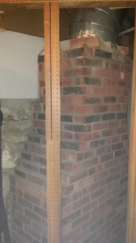

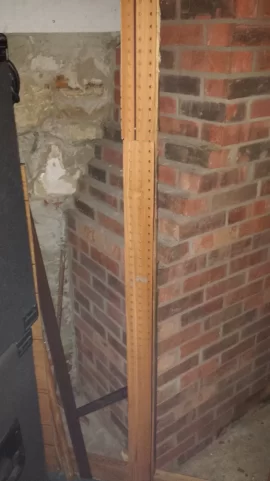

There is just the brick structure behind the stone wall and it stops right at the ceiling-

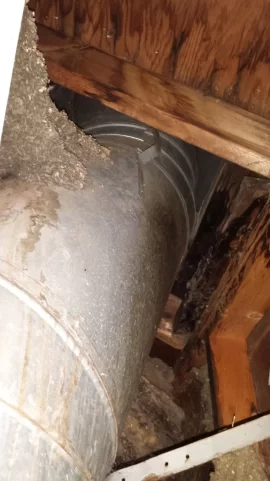

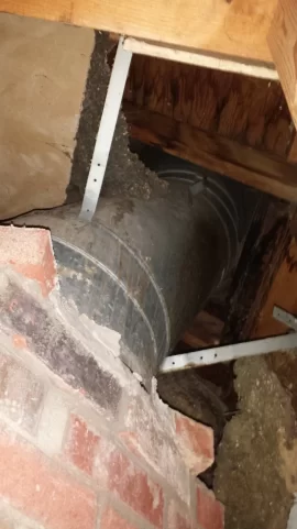

inside the attic is only metal flue pipe / ducting. looks to be 8-10" inside diameter with a 12" (?) double walled outside?
looking up through the hole you can see the damper /flue plates (?) and inside 'end' of the duct pipes-

Looks like an odd combo on the backside. If might be ok with a liner. How tall is the chimney? One thing you can do is visually follow that pipe and look at its clearances from any combustible material. That includes studs, drywall, roof decking, roofing.
The top of the bricks on the backside is 78 inches.
There is a bunch of blown in type insulation around the pipe in the attic that I will be removing tomorrow.
I was thinking to just replace the liner and make sure nothing was touching it passing through the attic.
The roof is a hip style and it does get tight in the attic over where the pipe runs. might be issues with clearances there?
I am pretty sure there is a triple wall liner in there, it might just could be double.
All of the liner / piping looks fine aside from the end piece just inside the house. Looks like a sloppy removal caused that end to be cut or ripped. I am thinking a couple sections of pipe would make it right again but I want to verify triple or double wall and make sure the rest is in good shape. I can see clouds when I peek up and I have made sure no critters have nested anywhere all the way up. all clear there.
*been waiting on the inspection for a week, the guy is a busy man. Sorta like to get as many opinions as I can....

If you want to put a freestanding stove or an insert in there it will need to have a new stainless liner. Most modern stoves require 6" and a 15ft high chimney.
There's a lot of water staining on the wood in thae first pic...
I am no professional, but looking at those photos makes me very concerned that ship ain't right there.
1973, Heatalator zero clearance fireplace units were very popular, relied on a flue system that brought cold air down the internal outermost section of the flue, hot gas up the middle. Great for ambance lousy as a heat source. Parts no longer available, chimney/flue capping system always first part to go south resulting in water leaks. If its been up there this long you likely have some bad roof decking in that area and adjacent to it. ( speaking from experience) As these were self-contained there was no need for fireproofing in the structure surrounding it. I do know there were some other makes of a similar nature at the time as well. Basic systems the same though.

Thanks guys for pointing out the leaky roof, there is a new roof on now and those leaks are from old damage.
the decking is fine. the chimney and cap are sealed and no longer an issue.
