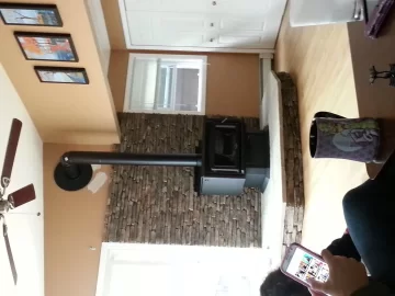

Thanks for the help guys. Again pardon my lack of knowledge. The Chimney Height inside the house is about 6 Foot, and outside another 6-7 Feet. Iam not sure what kind of wood was delivered suppose to be all hardwoods and the guy i ordered from said its been sitting for about a year. I attached a pic of the chimney and wood delivery. The Pieces are large about 16-18 inches long some larger and about 3 diameter again some smaller and larger. I have a magnetic thermometer on the top of the stove and when filled with 3-4 large pieces temps get up to 550-600 degrees. I then turn the damper all the way off to the left and am getting great secondary burns but the wood just seems to be burning down so quickly. Maybe thats how its suppose to be and it just seems like that to me. Thanks again for the help.

The wood in picture 2 looks pretty freshly split? Those gray pcs you see in the photo look like they maybe 1 year split and your driest, Try a load of those gray splits. My wood is well seasoned and they turn grey silver color. Also remember 50% of your heat is flame 50% comes from good hot coals, Your not going to get 6-8 hours of flame. jay
I agree that the wood looks pretty fresh. I buy about half my supply and cut the rest. The fellow that brings it, like just about every other firewood seller, always describes it as "seasoned". You will find that buyers and sellers often have a different definition of the term. It took me awhile to realize just how long it takes for wood to truly "season", especially wood like oak. But it makes a huge difference in heat output. Getting truly seasoned wood is usually a challenge the first year or two when getting into wood burning.
