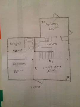

Here is a picture of our layout/room sizes. The upstairs has a 1/2 story cape cod bedroom. The stars are the three places we are thinking of installing the unit (the fourth in the sunroom in the back is probably a separate issue, that room is largely uninsulated, walled off from the house and on a slab).

I should probably add that star #1 is largely our preferred location for other reasons (possible future changes)

I would choose 2 or 4.
1 would be right in front of the door and in a path of travel. This could be annoying over time in my opinion. 3 would look great inside, but chimneys on the front of the house always bothered me aesthetically. There isn't anything wrong with them functionally. If 3 could be moved back to the centerline/just in front of the main beam I'd choose that. 4 would look good aesthetically, but the heat would have the longest path of travel to the bedrooms. Depending on how the sunroom's roof is set up you may also experience draft issues when the wind blows just right...

My vote, like Jetsam's, would be for number 2 or 4. I like the idea of having a stove centrally located, but if your sunroom is a chilly spot in winter, and your purpose isn't to heat the whole house, it would make sense to have it there if you like to spend time there. If no one would spend time there anyway, though, then it would be a non-starter. Also, if it's a one-story addition on a two-story house, that could cause issues for the chimney.
For numbers 1, 2, and 3, one big factor to think about is the living space upstairs that will have to be closed off around a chimney. If there's a hallway above number 2, for instance, you just wouldn't have room.

My wife would say definitely no to 3 if the chimney would be on the front of the house. I personally would go with 2 because it's not in the walking path of the front door and messing with the flow of the house. Someone mentioned the Explorer 1, I just installed the 2 and have no regrets, it heats far more of the house than I ever imagined.

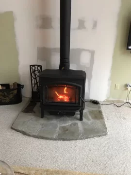

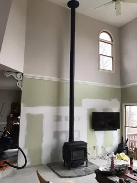

we did not get the screen, we may in the future, the glass is very large so we get a good show, plus I wanted the stove for heating more than for ambiance, but it is nice looking too, running it open with the screen while nice and will provide heat just not as much, I wanted to heat for long periods of time.
here it is set up (back wall a work in progress)

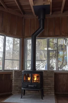

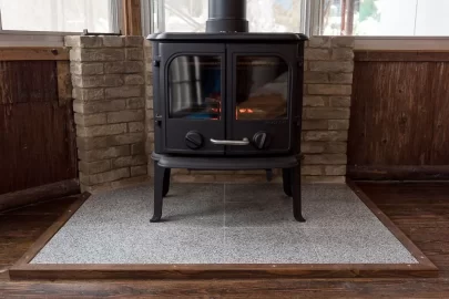

I just installed a Morso 2110 in my son's cabin and it looks really nice. The cabin is still under construction so I can't say much about the performance.
I really like that tall straight pipe, very attractive! I wonder often how the "open door viewing" works with smoke etc. since the air wash systems would assumably cause some smoke to be blown out the door?

That stove looks SO nice in there, just curious how you landed on the 2110? Do the double doors offer any benefit?
With the draft I have I doubt I would have any spillage of smoke, if you were open door viewing, you probably would have the air control all the way closed since the open door would provide quite a bit of oxygen to feed the fire

That depends entirely on your draft. With a good, strong draft there probably won't be any smoke spillage. Draft depends on at least three factors: 1. Chimney configuration: straight, long vertical runs make for good draft. Too many turns, too much horizontal and the draft suffers. 2. Chimney materials: class A chimneys are the best. They are double walled and insulated. This keeps the temps high within the chimney, making for better draft and less creosote. 3. Stove temps: draft gets better as stove temps rise.
I have very good draft in my home stove (Napoleon 1400 and very long class-A chimney) But still, sometimes I get smoke in the house when loading the fire, especially if it isn't very hot. Opening the air control helps but still some small amounts of smoke get in the house.

We chose the Morso 2110 because my local stove shop sells a lot of Morso stoves and offers very good discounts; because it's a great looking stove that seemed to blend in well with the cabin, and because it was the right size for our space.
