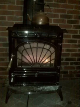

This stove came with the house, it seems well made, but has always had a smoking problem, maybe from the way I used it, maybe from too short of a stack, maybe too green of wood, maybe a combo of those. I have just not used it much because of smoke. I've never had a manual, so maybe I could make it work better with an owners manual.

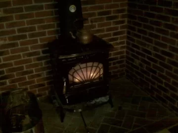

I've included a couple of pics. It says waterford on both sides, the firebox is very small, but it is set up to have a secondary burn. Finished in black enamel.
I've played with this stove the last couple of days, got a good secondary burn going, only had to open the windows 2 times to let out smoke. The little knob at the top to move from regular burn to secondary burn gets about 250 °F , ouch. The only way to have a regular burn is to open the ash door (if there is another way, I have not discovered it).
There also has never been any kind of damper in the stove pipe, I'm guessing it needs one to get any long term burn - is that correct?

Looks like that may be an Erin? Can you describe the flue pipe that is connected to the stove? We need the diameter and the height. The pipe on the stove looks large, like maybe 8"? If the pipe is too short, or too large in diameter, a damper is the last thing you will want to add.

It has 2 options for stovepipe, one out back (round) and the one out the top (oblong). I agree stove pipe is probably 8", but I'm not home right now to measure. When I get there I'll take some measurements for back outlet and stovepipe.
Could the smoke problem be from too large of flue pipe?

Just an update, you were right, it is an Erin (e). I found a manual on Regencies sight (after 3 phone calls to regency dealers) under discontinued stoves. Thank you so much.
If the pipe is oversized (8") and short (less than 15') the draft may be weak. That would explain the smoking problem. Add unseasoned wood and it can make for a disappointing experience. The good news is that this is a nice little stove. Long burns are never going to be its strong suit, but with decent draft and good wood, it should put out some heat.
