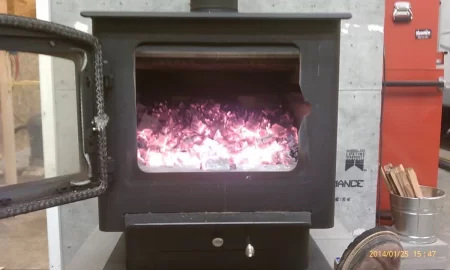

My NC30 is run hard on softwood or low btu hardwoods. Coal buildup can also be caused by running too hard. See pic.
My glass stays very clear on the NC30. Just dust.
The stove really seems to have a hard time burning slow. It's either really hot or too cold and smokey with dirty glass and foul emissions. I like to keep it at the 700 mark.
