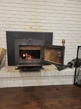

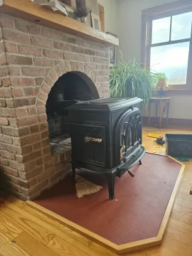

I am writing to help with selecting a new wood stove. I currently have a 1970s hearthmate wood stove (given to me for free) that I have used for the last 3 years. I want to upgrade to something that produces far more heat and is not falling apart (its warped and the dampner is bent). The hearthmate can keep my entire house warn until 20 or so degrees before the furnace has to help. My fireplace is currently to small to fit any insert without cutting the arch away. so this will lead me to a stove and a rear exhaust ideally.

I'm at a Airbnb that has a jotul f500 v2 and I really love the look. I been looking up the jotul f500 v3 and hearthstone Manchester since they for 20in logs and have rear exhaust. I am hesitant to buy either one as the cat worries me. I have a box that can burn anything and does not care about moisture. My wood is uncovered until 2 months prior to burning, so the moisture is relatively high.

-current stove is bolted to the face of the fireplace and is not a insert
Also, don't bash the painted brick. The house was bought from a smoker and was the only way to seal the smell and tar.
