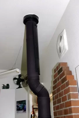

This is 6" pipe, but you get the idea. I used two 45's, but you could also use two 30's if two 45's moves you too much, or even two 15's. Rick
