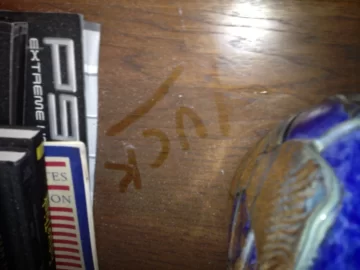

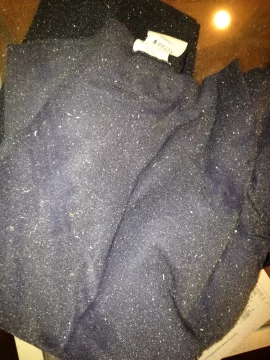

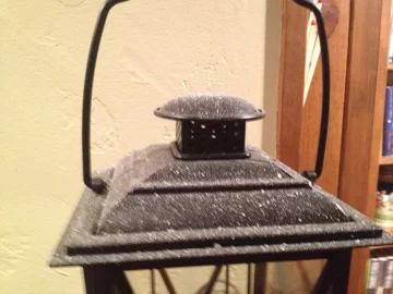

Stalked this forum and put in a flush mount hybrid. Great look. The issue is ASH! No matter what we do, we have a film on everything. Upstairs (open concept second story w/ fireplace on first floor) is so bad that we had to have hardwood floors professionally cleaned. Had this unit professionally installed by a good reputable local longstanding company. They first said our wood was wrong (kiln dried) so we bought three full cords (1 kindle, 2 of hard oak). Bought the moisture tester, all new wood is within acceptable range. We pull out the top knob to load (per the manual instructions). We rarely do slow burn. Serious ash - so bad that entire house is dust coated every week (we burn most nights). We clean box every 2-3 days, so ash buildup is NOT the issue. We have let the buildup go longer, and cleaned more frequent. No change in ash output on our furniture/floors/air.
Could it be the install? The catalytic converter? Really need help. Fireplace company coming out again next week. HELP PLEASE! Picture attached of one week of dust in a room that does NOT contain this darned fireplace!. Ready to have this pulled and have my large open fireplace back! NOT HAPPY!!!! HELP PLEASE!

I've never heard of this happening.
Please give more information. How is the avalon hooked up? Details re the install please. How tall is your chimney? Did you previously use the fireplace? If so, did you have any ash issue? Do you SEE ash come out of the insert when you load? Does it seem to happen when you are NOT burning, as opposed to when you are burning, or do you not know? Are there any telltale avenues of ash anywhere near the insert that would give any hints? How long have you been burning? How much wood have you gone through? Have you had the problem since day one, or did it develop? Are your CO monitors reading normal CO levels when burning? Are you burning 24/7? Have you removed and checked your cat? It may be blocked, in which case air can't flow properly when you try to engage the cat, and you'll get a messy burn, with air (and flue gases and ash) coming out anywhere that offers less resistance than a clogged cat...

WOW - Went to bed last night after posting and you people ROCK for answers! Will try to answer your questions. Would LOVE if this were operator error, TRUST ME.
1. House is 12 years old. High end, full masonry fireplace with 42" opening that we burned nonstop. Realized VERY inefficient for WI winters (we only bought the house 2 years ago. NO ASH issues with open fireplace. No glass or screen with that one, burned nightly. Flue cleaned before insert installed.
2. We have a LARGE Cape Cod. Fireplace about 3 feet taller than the highest point on second floor. No wind blocks from any angle. Again, no issues with old fireplace. The blower is wired through the old ash dump in the basement. Other than that., not sure of other details on install (I do not claim to know the first thing about fireplaces).
3. Installed an insert in October, 2012. Used this company before, really - they are reputable. We did NOT go with the cheapest - we went with the two man show that does many high end homes. They only offered kiln dried as a possibility, not as a solution. They were unsure.
4. We do open the top know (bypass) EVERY time we open the door. For loading, ash cleaning, etc. It is only me and hubby, so it is not like we have kids that are sneaking the door open.
5. We are on full cord #2 this winter. Some was burned with old fireplace. But we burned this new one almost nightly since we got it. Darned cold in Wisconsin this time of year.
6. Obvious ash issue is on the AIR INTAKE - as it sucks air in (on the bottom of the unit facing the great rom) we have to vacuum this almost weekly if not more often. Totally clogged. So, this shows (to me) the enormous amount of ash floating.....Hence the pictures.
7. Unsure if ash is coming during burn or non burn time. Just know my hose is coated in ash to the point that people comment - and I dust 100% of the house weekly. My leather furniture has a film on it, and the pics above show the rest of the house.
8. Have not looked at the cat - do not even know where to find it. If it is blocked, it has been blocked from day one. This has been an issue since day one, so not sure how the cat could have been blocked. We called the company on the third week of ownership to share our ash/dust issue, and that is when they questioned our wood choice (as they noticed the wood when they did the install).
9. Finally, I am a whacko about the dirtiness of a wood fire and have an ash vacuum that I use every other night on the hearth when I am vacuuming the intake area (that is coated).
THANK YOU so very much for your input. I am hoping I do not sound defensive or like a know it all. I really want to find a solution. I am also copying this thread to send to my dealer (who I REALLY do like and trust) to give him some ideas.
Again, THANK YOU for taking the time to help. Any more questions or solutions are so appreciated!!!
