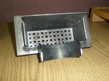

I had the same problem with my 25pdvc. Could not go 24 hours without cleaning the pot. I ended up making a complete new burner pot. Now I can go 7 days without opening the door and can burn any brand pellets.

Can we get the specs on this burn pot. I would like to try that out. Looks like the pot on my 55SHPEP stove .
Nice workmanship on the weld job !!

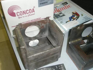

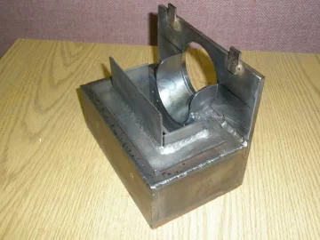

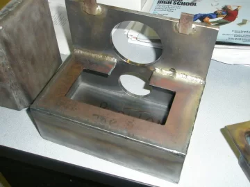

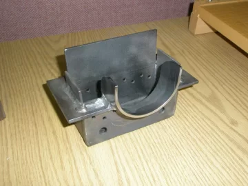

Hi Guys: Like Bubibear said the burn pot is from a 55-shpep part number PU-BPEP that I modified. The lower part I made up to fit. Enclosed is more photos

Thank you for the extra pics. Did you also add those tabs on the bottom of the impingement plate ? Or did the plate come that way. Being a retired machinist ,are dimensions available ? My E-Mail is bubibear@roadrunner.com.

Hi: First, yes I will post drawings , and right now the igniter does not work but I have a idea for one. But right now the stove runs 24/7 so it is not a problem. The tabs were on the impingement plate . I was going to use the original pot but the sides were to high for the ashes to carry out . I can post more detailed photos for anyone if needed and I will try to post a video.

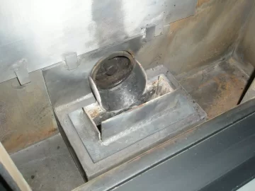

Update on stove. Turns out it was on burn mode "A". So I reset it back to burn mode "c" and readjusted bottom three. All was good for last 2 nights. Then this morning major burn pot overflow.
Huge pile up after 3 hours of burn time.
