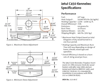

Just to be sure about terminology, is this the "lintel depth" circled in orange? If yes, on the Jotul C450 it's adjustable.
Edit: Hmm, if the start of the pipe has to be 8" into the FP cavity, then that won't work. Even at 9.25", the front edge would be 6.25". How exact is the height dimension? It looks like a Hearthstone Clydesdale is just a skosh too big.
