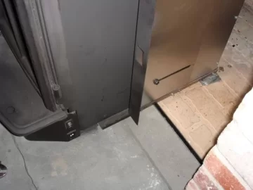

I'll try and post some pics later if I get a chance. On my stove the only movable (adjustable) part is the sleeve that holds the surround in place. If you slide it all the way forward then the stove is at it's most recessed position, and the surround fits fine. If you slide it backward (after you remove the half-moon knockout plate on top) then the angle iron is exposed along the bottom of each side and interferes with the surround.
Here's a pic of the "U" channel I'm talking about. It's the piece on the bottom that runs along the entire stove, and is visible in front of the surround sleeve. Right now the sleeve is set so the stove is in its most extended position. Although it looks like the bottom of the sleeve and angle iron line up with each other on their out edges, they don't. The angle iron, between both sides, is about a 1/2" wider overall.
