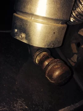

Cool, it does look like our Sellirk DT which is good for wood pellets and corn but I do not see a nice handy vacuum clean out? Do you install them?

Okay, cool, another question about intake pipe, what can I use for that? Would duct or b type vent work for an fresh air inake? Or are there better alternatives?
Generally a metal pipe of sort in case of something really rare happens. Nothing fancy. Chunk of car exhaust pipe hooked up with metallic flex pipe. Make sure the exposed pipe is capped for rain and snow and has some screening to prevent birds and bugs etc. Some have used a dryer exhaust kit as it has a wall thimble and outside cap and have added some screening.
The Selkirk DT comes with the 3" flexible fresh air pipe as part of the Kit. Also is heavy enough to burn corn.
intake MUST be metal pipe to meet code due to potential back venting out the intake in power outage or malfunction.
