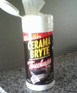

Cerama Bryte wipes.... they are new, work pretty good too.
They come in those containers like the clorox wipes.
