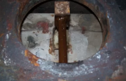

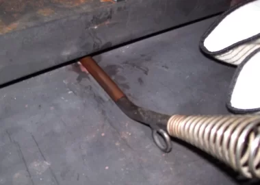

Hey Everybody,
I am a new member, and an owner of a BV4000C. I am looking for anyone that has knowledge on this unit. I have had mine for about 3-4 years. And I downloaded the owner's manual, but are there more instructions or pictures in detail on these units? My dampner lever is broken, and I am not sure that I have a catalyst filter? Hmm Questions, questions, questions... Other wise the thing is awesome... I do burn a lot of wood, wonder if it has to do with the catalyst part? Any help is a ppreciated.. Thanks

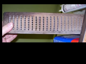

what part of this damper lever is broke?
also a pic of my combustor to see what part you are missing.
