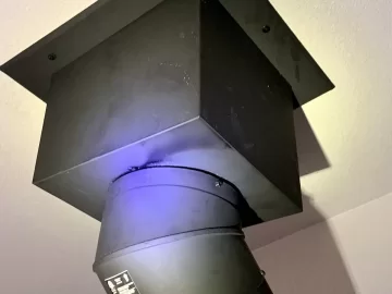

I have a PE Super 27, using it with no issues since October 1st. I just noticed smoke in the house, for the 2nd day now, and did some inspecting. I found that a tiny bit of smoke was exiting my inside stove pipe, where it meets the box at the ceiling. We've been using the stove now for almost 5 months and no issues like this to date. We did have smoke in the house yesterday on startup, and I was very confused. The smoke alarm actually went off. I just figured it was a weird inversion or something like that, as it resolved in about 10 minutes, with a window and back door open for a bit...
It has stopped smoking now, I believe because the pipe has now expanded enough due to heat to close the gap there. But what has caused this sudden change?
I do see, using a flashlight, that there is a black mark on box where the pipe attaches. I saw a bit of smoke and actually one tiny piece of ash come out before it stopped. Any ideas as to what is going on/why this would happen out of nowhere? Did I have a small chimney fire up there? Is there an obstruction? I've only been burning seasoned dry maple and fir, with a MC of around 15. I have maybe 4 times now used some pressed firelogs to overnight the fire on very cold nights. Any help or guidance would be appreciated.

Check the chimney pipe and chimney cap. If the cap has a screen, there is a good chance it is plugging up.
How is the wood being tested for moisture content? On the outside or ends? Or after being resplit in half and tested in the middle of the freshly exposed face of the wood?

The cap does have a screen. Why would that plug it up?
I have a meter and test the ends of the wood...should I split some and test the insides? Our wood catches fast and I hear no sizzling/bubbling etc the way wet wood does.

Think of it this way, a clogged screen is like putting a plug in the exhaust pipe of the car. The smoke has to go somewhere.

So I've discovered that the smoke comes out of the pipe/box area whenever I open the stove door. As soon as I close it - it stops. Thoughts?

I climbed up on the roof and took off the cap and screen. Used a poly brush to sweep the pipe. The screen was fairly gunked up. Left it off after cleaning everything up really well. There was very little to clean up from the pipe itself. Must have been that cap/screen.
I was so confused as to what was going on because this is my 3rd wood burner now, and I've never experienced anything like this.
