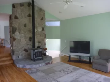

Here is a picture of my set up. You can see that it is a pretty open room with a cut out in the wall to the stairs going up to the bedrooms. The heat goes right through that cut out and heats upstairs. What I want in a stove is what I have seen in showrooms- total control of the fire from a single damper rod. Pull it and boom, big fire, push it, and the fire goes right down for a long burn time or completely out. In an emergency, you could not put out a fire in my stove, it just gets too much air. I have been told that you can't really put a fire out in any stove and that they will all continue to burn to varying degrees. The Lopi Cape Cod appears to be a catylst stove I thought. It is 80% efficient with a large fire box, ash pan, and nice functioning dampers (on video). I don't know what they cost though. I can get a nice enamel Mansfield with ash pan for $3180, and the Progress Hybrid is $3295 plus delivery. My Fireview is almost thirty years old and this says a lot for Woodstock, but the Mansfield is gorgeous and the Lopi looks very functional. Tough one.

Very nice looking setup. I have a cape cod insert very easy to control. Freestanding cape cod is a hybrid stove, I think it would cost you $3500 at least that's what my dealer was asking for it.
