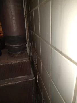

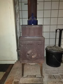

This old stove- while I have grown to admire parts of it- needs to go. It is quite damaged. I am looking for a replacement WOOD-stove of similar size, preferably steel, as I have seen what can happen to cast stoves if used improperly, and I am no professional- but I have an open mind. Throw suggestions at me, keeping in mind that I have 10" to the side of the pipe and 3" behind it... I am in a tight spot!! Stove measures 13"W x 28"L x 14"H (21"H including recirc chamber) not including legs... I am also contemplating moving the stove outward, farther away from the corner with 45° pipes...?

Eek. I sure hope that what is behind those tiles is 100% non-combustible, like cement block and not wood studs. That is really close. It looks like wood is also close on the left rear of the stove. I don't have the manual for this stove but I would guess that is specifies at least 24" clearance back there.
Agreed, it is Way too close. Are bent pipes a viable option?
I have a feeling you'll need to do some offsets. Once you agree to that i just installed a pretty small stove with 5" wall clearance (I extended that though on my install). Its a Pacific Energy Vista LE. Their website is good. Good spec sheets available- take a peek and see if one will fit.
Yes, offsets can be made in the stovepipe using elbows with a straight piece between them. A close clearance stove, brought further out into the room would definitely improve the situation. The hearth may need modification if the new stove is not a box style stove. How well did the Waterford work for you?

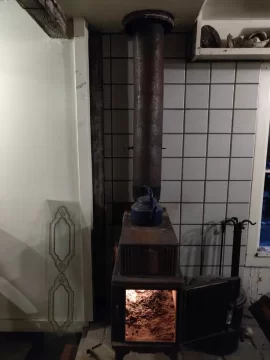

I'm not sure what the concern is about support. Can you move the camera back and post a picture of the stove, stovepipe and chimney connector?

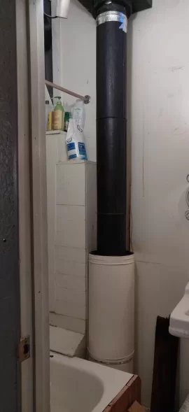

Apologies for my messiness- the stove has been country/ghettosealed with mud, and the stove pipe leaks which is that trecherous brown stain as seen in top picture.

The flu sticks out another 6ft above the roof; it is hefty...

Ok. The pictures help, they say a lot. You may already know this but the fact is that this is a completely illegal, dangerous and improper install. Stovepipe is NEVER allowed to be used through a ceiling. It is only for use within the room envelope. It definitely looks like a homebrewed installation with a serious lack of safety knowledge. The chimney pipe should have continued on down to the 1st floor.
Once that is fixed, a double-wall stove pipe connecting a stove with close clearances will improve safety and performance. You'll get more heat and longer burns with less wood and you will gain a nice fireview.
A double-wall stove pipe connecting a stove with close clearances will improve safety and performance.
To be clear, double-wall stove pipe is the same as chimney pipe, correct?
Safety and performance are two things I look forward to! Uninsulated roof has me begging for more efficiency.
You may already know this but the fact is that this is a completely illegal, dangerous and improper install. Stovepipe is NEVER allowed to be used through a ceiling. It definitely looks like a homebrewed installation with a serious lack of safety knowledge.

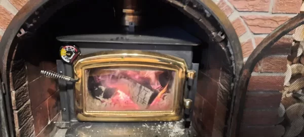

I have a Regency i1100s that I have been using recessed into an old fireplace. Its a nice small unit that can easily be used as a standing stove that has a blower.
It cannot easily be used as a freestanding unit doing so would make it an unlisted stove with 36" clearance.
I can't say i fully understand what you mean, this is probably due to my lack of experince in this area. As long as clearances to combustibles are adhered to and an inspector okays the work, would that be enough?
il admit I have not read this whole thread so I'm probably missing somthing. Regardless its a good thing there are active knowledgeable people on here and always err on the side of caution.
An insert is designed to go inside a fireplace. So there is no testing for clearance to combustibles on the box or the hearth. That means if it is not in a fireplace it voids the ul listing making the clearances revert to those of an unlisted stove. Which are 36" all the way around. Considering the op wants a stove for a tight spot that would not be a good solution. Not to mention it would be an illegal install because it was not installed to manufacturers instructions.
