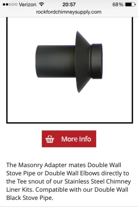

Rockford said put the snout into the adapter and then mortar the adapter into the thimble.
Here's the adapter I've purchased.
ok then
no i have never seen an adapter that you mortared in place.
I was reading Selkirks instructions with this adapter. It looks like you would mortar the snout in place and then slide the adapter into the snout.
Bholler you are correct and I think I miss understood what Rockford told me over the phone.
Thanks for your advise.
